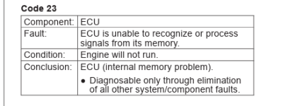

So I followed some directions, and the light blinks 2-3-6-1 and then pauses for 3 seconds and goes solid light.
Should be a four digit error code. And post the model and spec of the engine so I can make I am looking at the correct service manual.
Should be a two or three error code. And post the model and spec of the engine so I can make I am looking at the correct service manual.
It’s a Kohler CH26S, spec #78518.
I followed the directions, light blinks twice-one second pause-three times-one second pause-six times-one second pause-one time-3 second pause-then solid light( 2-3-6-1)
