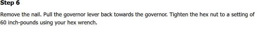

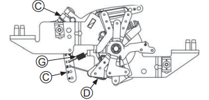

I went ahead and did the "governor adjustment" procedure that I found here: https://itstillruns.com/set-governor-setting-kohler-engine-8039721.html
It seems to only turn maybe less than 1/8 of a turn so unclear if that's normal or not. Same output, no change.
