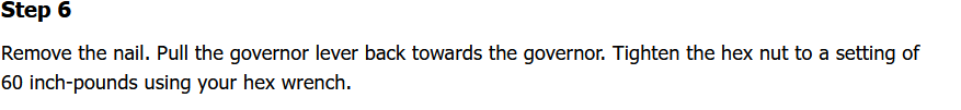

I went ahead and did the "governor adjustment" procedure that I found here: https://itstillruns.com/set-governor-setting-kohler-engine-8039721.html
It seems to only turn maybe less than 1/8 of a turn so unclear if that's normal or not. Same output, no change.

When you did Step 6 did the governor lever move on the governor shaft? This instruction isn't correct. It's close but step 6 puts the governor out of adjustment. The adjustment is correct up until Step 6. You want move the governor lever loose on the shaft until the carb throttle plate is wide open. Then turn the governor shaft the same direction you moved the lever. On most Kohler engines it's counterclockwise. If you just remember to rotate the shaft the same direction you rotated the governor lever to open the throttle plate all the way you can adjust any governor or any engine. Then before letting everything go, tighten the nut on the pinch bolt of the governor lever. Now you can make any fine adjustments with the screw mentioned.

Correct, i kept it in position for a throttle wide open the entire time. I watched a couple youtube videos to confirm this as that is a bit of a confusing step :)

As long as you moved the lever so the throttle plate was wide open then turned the governor shaft the same direction as far as it would go and kept it in that position while snugging that nut then the adjustment should be correct. If the engine was run with the governor out of adjustment you may need to replace the governor gear as it has possible come off. If you can manually grab the governor lever to slow the engine down and if you let go of that lever and it immediately goes wide open then either the governor gear has failed or the governor spring is way too tight.

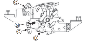

I don't see a governor spring. There should be a short spring about the diameter of a pencil or slightly larger. One end should be attached to the governor lever and the other end to that lever your throttle cable is moving. Item D below is the spring I am talking about.
