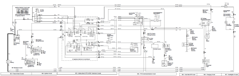

Mower will not start. New battery, new fuel filter, good gas, new plugs. Mower was idle for a few years. Fuel lines are clear. Carb may be a bit fouled but will start when spraying starter fluid and then stall when not spraying. Checked voltage to fuel solenoid and there is no power to the solenoid. Both battery and oil lights illuminate while trying to start so I think the circuit board is good. Green wires from fuel solenoid enter the wiring and wrap around to a disconnect on the other side of the motor. No green wires exiting the disconnect to continue on to the starter / circuit board. I suppose I could jump the power to the solenoid but would rather fix correctly.

JD have a habit of changing the wire colour every time it passes through a plug
I do not have an LX 277 manual, but on the LX 188 it is yellow + black then goes to yellow + White then yellow then red
And the power supply actually comes via a relay .

As it is Star has posted the circuit diagram so that is case closed, problem solved IMHO .

The diagram is combo version of 4 pages from the service manual hence the line breaks.With on a regular computer you can zoom in on the images in the service manual for clear details.
