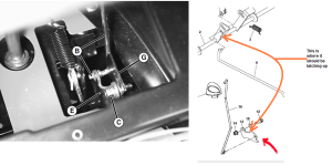

You pretty much hit on what the issue could be. You'll have to follow the linkage down underneath to make sure nothing is blocking #13. See attached picture.
Thanks for the parts diagram. Having that for reference should be a big help. In looking at the diagram, I conclude that the lug on the side of part No. 7 engages the "fin" on top of part No. 13 to keep it from coming backwards when the parking brake is on. Is that correct?
You're welcome. #7 is the part that connects back at your transmission, so #13 does not contact it. My recommendation is to take a look under your tractor and reference the diagram. It will all make sense when you look at it.

Problem solved. I managed to get a good look at the mechanisms and, with my wife in the seat and pushing the pedal, we jiggled things for awhile. The problem seemed to be a frozen pivot pin (represented by parts 12-15 on the diagram). I used a solvent to clean it out and then lubed it. Works fine now. I suspect that gravel dust and moisture around the pivot pin for the couple of months when the mower wasn't used caused the problem. Thanks for the help and suggestions from other members. Greatly appreciated.
