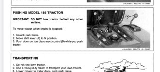

I have an older John Deere 185 hydro. I can't find the release so I can push it.
The Serial # is M00185B454279 185 Lawn Tractor W/46" RM
One of the techs at my local dealer says he thinks there is a lever on the right side under the fender but he isn't sure.
Any ideas???? Thanks in advance.
some were under the seat, some were on the fender deck between your leg, by your serial number I think yours is between your legs
Thank you. Mine is between my legs. I thought that was the lever but it won't move so I'm going to have to get under the tractor and check it out.
