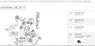

I've got a 50" zero turn Cub Cadet that I need to replace the blade spindles on. My model # is 17AFCACP056. There are so many spindle kits on the internet I can't figure which one to purchase. When I put in my model # in, I'm basically told it's a 50" RTZ mower, but there are still so many choices under than nomenclature I don't know which to purchase. I want good spindles, not some cheap junk that won't last. Any suggestions from experience?

PN 918-04125C for complete spindle with pulley ($109 each Retail from MTD/Cub,Rotary, or Stens). Or if you just want to rebuild them the bearings are 6204-2RS but don't remove the housings from the deck as the mounting tend to break if you and then it is new spindles. The mounting screws are 5/16-18 x .75 (3/4). Tri-lobe self tapping. Four needed for each spindle.

I just went to their site and the Search box said there wasn't a part with that number.

Well DANG!!!! I put the part number in the search box and was told they didn't have anything that matched it.
