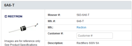

Hey all i was wrong i can make out the diode numbers i guess i looked at the wrong side when i clipped it off its t6a60

Yeah i was starting to lean that way till the diod replacement was shown here its a much easier fix if i have something that i couldnt repair as easy as just popping on another diod!

Personally I appreciate that Bearrepair took the time to post the component numbers for me to look up.
Now all I got to do here is to put these diodes on my next Mouser order.

Note the band is on the Cathode side. In this application the Cathode goes to the +12v side and Anode side goes to ground.
Anode Cathode
