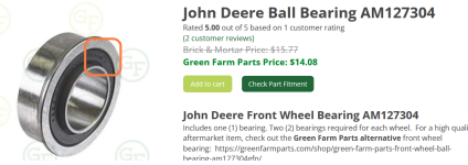

If costs are not a problem then use JD AM127304 bearings which are sealed on both sides. And there is the Rotary 6573 with removable back seals. Can't quote my dealer cost on the Rotary but here they are the route to go but the JD are better quality in general as I have seen those personally here and not seen the Rotary ones yet but they are on my next order for inspection.
#17
KM Richards
KM Richards
The JD AM127304 bearings are $19.99 on Amazon for a 4 pack... is this considered big money??? No sure bout everyone else, but $19.99 is reasonable for me.

I may have to try the JD AM127304 bearings or the Stens 215-211 bearings which someone commented on Amazon are sealed (the Strens website mentions one side allows for grease to enter the bearing which didn't sound very sealed)
QUOTE - are you pressure washing your mower ?
And as for sealed bearings, unless you buy very expensive bearings they will be lucky if they last a season. /QUOTE
No, I hose it off with a water hose and this has nothing to do with the crappy design of my wheels riding on bushings. When greasing it, you have to keep pumping it in until you can see it start to ooze out and then it's full.
Since there's no seal really to keep the grease in, it only takes 4 or 5 mowings for the grease to come out and the bearing squeak... after pumping in more grease, the squeaking stops.
I mow for about 2 hours at a time and I'm using Amsoil synthetic wheel bearing grease like what is used in automobiles so the grease is not the problem
Unless they are in a plastic sealed packaging with a JD part number on it, they are fakes
OFten vendors will take a photo of a genuine then send you a faked item
Classic was again supposedly genuine JD bearings because they had the JD part number etched into the side of the bearing, some thing that JD does not do .
I can get bearings from China for under $1 a piece
If I order 2000 or more they will etch what ever I ask for in the side of the bearing,
You have to take a step back and think when you order bearings
At $ 5 a piece the vendor has to be making $1 profit ( at least )
Amazon take $ 2 to $ 10 off the total sale price depending upon weather they are warehousing them or just hosting the selling softwear , so we will call that $ 2
This brings down the price of the bearing to $ 3.50 a piece at the vendors warehouse
The cost of High Speed Steel that good bearings should be made from by weight in a 6203 bearing is around $ 1 and that is as a slab directly out of the furnace before rolling precision grinding assembly & testing and if you think all that can be done for under $ 2.50 a piece and we are excluding boxing , freight, tax & profit for the bearing factory then you have had one too many visits to Disney Land
The last thing I would buy off Scammazon would be the most counterfitted product onthe planet ,,,,bearings
Particularly as there are hundreds of genuine bearing shops to choose from

So this particular JD bearing, how much should it cost?
And, where can I find a vendor selling the real McCoy?

They are called John Deer agents & I am told there are around 75,000 of them in the USA
Most real bearing shops, you know the ones you can walk into & lean on the counter .
They will have genuine bearings
IN $ A I cab get spindle bearings for 4 different prices from the junk Chinese ones intubes from JAk--Max through to the boxed Nachi's from RGS.
Stens , Rotary, prime Line & oregon all do the same bearings and all of them have "Find a dealer" feature on their web page.
After that there are dozens of places like ProParts Direct, Jacks Small Engines, Small Engine warehouse, Small Engine Supplies, K & C Mowers , Messecks E-replacement parts & parts Tree who do on line sales .
And ONLY John Deere agents can sell these?
I find that hard to believe....

Did I not mentions that ANY real specialist bearing shop will keep them ?
As for cost you are in the USA & I am in Australia so I have no idea about bearing costs in the US
Most stuff over there is cheaper than down here even when I allow for currency conversion which is to be expected in a market that is 10 times bigger
I pay $ 15 WHOLESALE price for the bearings I use in Spindles because I want good ones that will go the distance .
Now I can get them down as low as $ 3 a piece which would be fine for a low load application like a shopping trolley .
Unless people have worked in manufacturing they end up with unrealstic ideas about what it actually costs to make things.
Unless they have worked in warehousing & transport they have unrealistic ideas about the logistical costs involved in getting those bearings into the purchasers hands .
Now a $ 5 US bearing direct from the factory could be an OK general use bearing but at retail level there are a lot more costs and anywhere from 2 to 5 more profit mark ups many of which are 50 % or more .
Now those Amazon bearings could be genuine, bought from a closing down dealer at below wholesale costs price or they could be NOS stuff being dumped to pay a tax bill because it is cheaper to loose money than borrow money or they could be fakes , quality control rejects , flood damaged etc,etc,etc .
Every day I hear the consumer advocates hammering home the adage "If it is too good to be true then it isn't true"
And every day I hear about beople being hood winked , scammed or products failing because they did not stop and ask that single question
When we see something that appears to be a bargan the natural instinct is to grab it now while you can then consider why it was a bargan latter on .

Here is what the bearing look like.

Yes of course... only John Deere agents have the really really good quality parts that are not made by the chinese communists laughing6.gif

BS. JD bearings are made in China too
