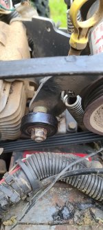

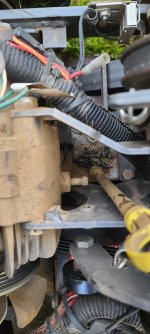

I went out today and bought a used 62" side discharge deck for my 26hp walker mower. Got half the yard done and one of the pulleys melted down! Any idea on what happened?
Thank you in advance!

Bearing lock up.

Bearing failure, I would remove & inspect all idlers & belts for replacement.

As mechanic Mark says , siezed failed bearing , its all blue excess heat , possibly not enough grease, or it got washed out during cleaning of machine

On another note, might wash that filthy engine off. All that dirt will insulate the cooling fins and over heat the engine. Cooling fin cleaning is a yearly maintenance routine.

Bearing failure. Took it to my dealer replaced all pulleys, and replaced belts. Hydros we're fine. Working like a champ. 2008 year model with less than 300 hours.
