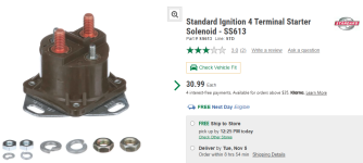

Rivets this is what the Standard SS613 looks like.
And this is what Toro is showing
So an aftermarket from Oregon, Rotary, or Stens would the same as the Toro. Just want something that is higher in amp rating than 80 amps.

Okay. New key switch. New battery. Cranked right up, but when I turned off the key, the starter kept humming. Took the starter to the shop where they rebuild starters and described the whole situation. Starter tested fine. We agreed I probably had another bad solenoid. Went and exchanged for a new one and installed it. Turned the key, and absolutely nothing. Now I'm really stumped.
