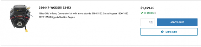

I checked this website https://www.smallenginewarehouse.com/Repower-Old-Equipment/Grasshopper-1822-Category and there is a engine that says it's a replacement for Grasshopper 1822
356447-WODS5182-R3
18hp OHV V-Twin, Conversion kit to fit into a Woods 5180 5182 Grass Hopper 1820 1822 1825 1850 Briggs & Stratton Engine
But at the bottom of the page where it says
FITS THESE MODELS​
  • Woods 5180,5181,5182 & Grass Hopper 1820,1825,1850
The1822 isn't listed. What do you guys thank, will this engine work?

Yes it says that but at the end of listing where it says
FITS THESE MODELS​
The 1822 isn't. That's my concern. I emailed the company but haven't heard back from them.

It could just be human error when writing that page. Emailing them was the best thing to do.

Thanks for all the info, now my decision is do I try and rebuild my engine or buy the Woods engine. I'm leaning more towards buying than rebuilding.

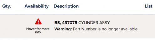

3 part numbers for cylinder - 394687, or 394900 which supersedes to 497075. I have a 497075 in surplus stock I will sell for reasonable price, but suggest you make a list of needed parts and see what is available. Right now the website to check stock on cylinder current price and stock is down. The Cylinder I have is new, returned with a small section of the top fin broken, was replaced to customer on warranty.
this stock can be found at VanDervort Repair and rebuild 607-625-4658 http://vrr.dyndns.biz
