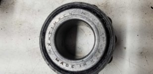

Look at it for writing. Most quality fuel line will have size and company name on it. I have seen the rocket scientists at auto parts stores sell vacum hose for fuel line because since it wasn't high pressure fuel injection that vacum hose would work. I was at a NAPA of all places last week looking for an odd tapered roller bearing and BOTH girls behind the counter didn't know what a tapered roller bearing was or how to measure them. I had the bad one and one girl tried to use a tape measure and there was a dial caliper in the drawer she got the tape from. Asked her to use it and just got the deer in the headlights look. This after I gave her the measurements in thou and metric. Her name tag said assistant manager. I guess McDonald's wasn't hiring.

what worst is most taper bearings have their part numbers on them; unless, they were very cheap after market ones. Just a magnifier glass helps to see them.

The bearing said timken and USA but didn't have the number which I thought was strange Bearing.jpg
