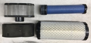

There is no comparison looking at the filter media plus the cyclonic action of the air spins most of the dirt out.
Stock stuff on the left. Watch that the filter is glued all the way around to the black plastic base part. A lot of the import ones have gaps that let unfiltered air in.
