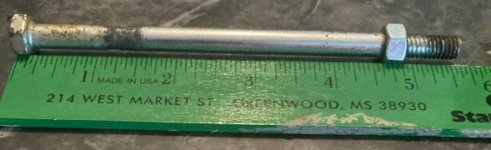

Any idea where this bolt came from. Noticed it in the back yard after mowing and assume it came off my mower but haven’t noticed anything missing. I have a 2021 bad boy maverick
My thought is there are a couple washers and the other nut that holds it on are missing Basically sandwiched to something. Did a search of the parts list for his mower but didn't find anything of that size.
Looks like it may act as a guide on the back of the deck and it shows 2 nuts being used on it to attach it to the deck shell, one of which probably loosened is laying in your yard somewhere

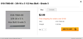

Using your image, that is a 5/16 bolt.
The 5/16 that is that long used on the mower is the one at the PTO clutch.
Anti-rotation bolt that keeps the clutch from spinning.
Using your image, that is a 5/16 bolt. View attachment 69095
