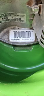

Wondering about where you're located and if you still have this engine? I just picked up an identical jx75 built in 2004 that I'm working on with my son. Still troubleshooting, but it sure looks like the piston rings are shot. Hoping to borrow a borescope from my neighbor later today or tomorrow to check out the piston and cylinder. I see that rings aren't too expensive so may go that route if everything else looks good.
If you're open to it I'd consider buying your good piston and rings (plus maybe a few other things) or if we live close I'd entertain selling the mower we have. Maybe one of us can make 2 broken engines into one!
Thanks!
