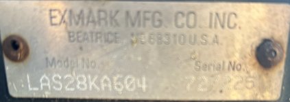

Thanks to everyone that responded!
Figured it out
At first all safety switches tested good but I went back through them and the one on the right lap arm tested bad. Luckily I had one in my shop.
Fired it up and released the park brake and it stayed running
