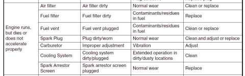

Also, for reference from the manual:
Rivets
