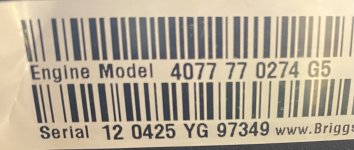

We need the engine numbers off the valve cover if B&S or the white label if it is a Kohler.

It’s a Briggs & Stratton. I pulled the mower deck off and the crack seal was laying on top of the drive pulley in one piece. What could cause it to come out? My thought is crankcase pressure.
