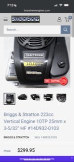

For example, I see this engine for about $300 that seems to fix the specs you outlined - I presume this would fit?

No what I was saying the only direct replacement recommended by Briggs was the 125P07-0047-F1. If you want to put a higher torque engine in this should have the same mounting pattern as it is basically the same engine with a slightly larger bore. IE 14 CI vs 12 CI. As Tim the Tool Man says "more power".
