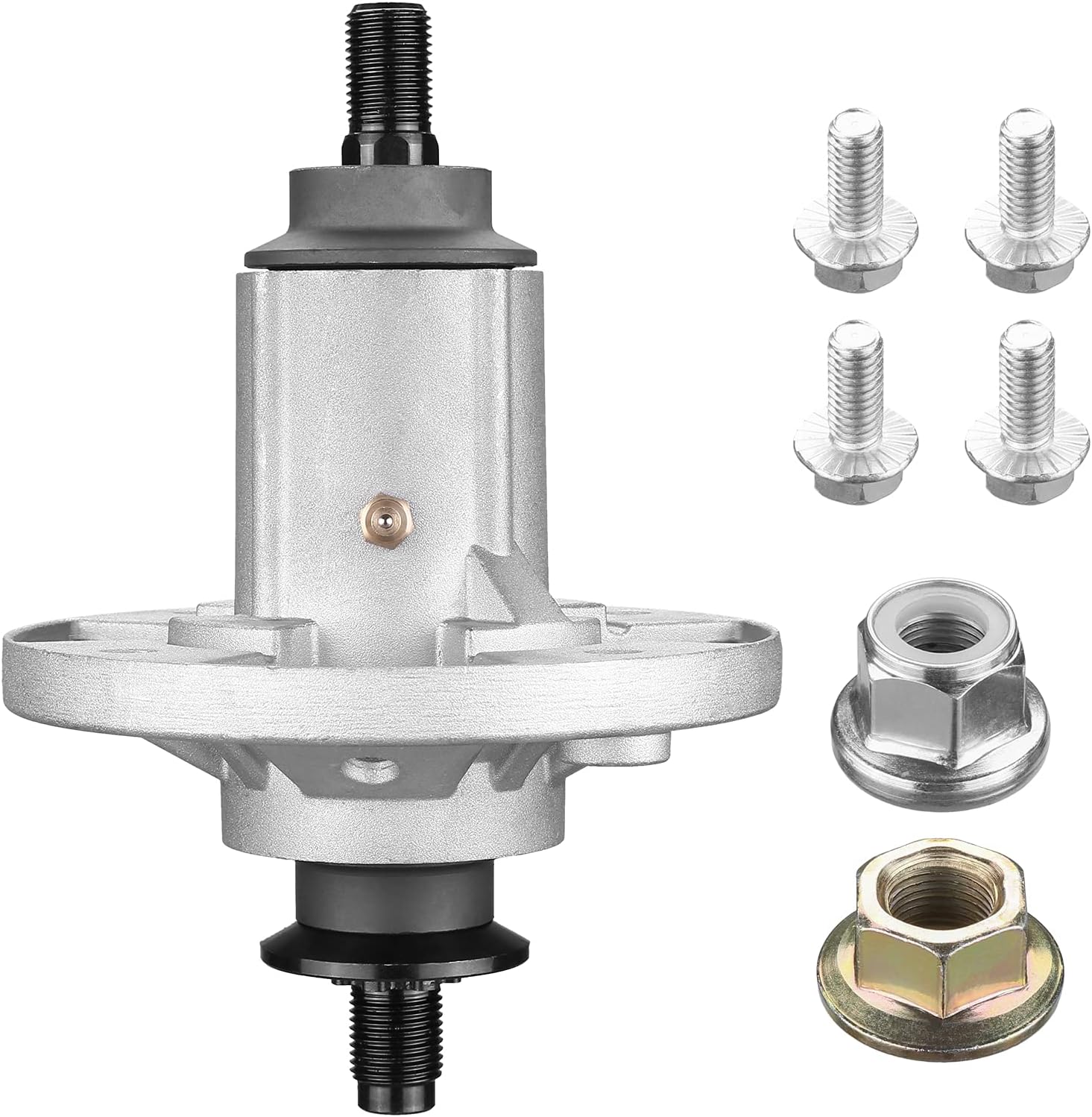

I've read some conflicting information so maybe you can clarify. I've heard that greasing the spindles doesn't help since the bearings are sealed. Is this true? The directions say to grease the new spindles, so maybe some are sealed, and some aren't?
103
11,832
It depends on how the bearings are setup and installed. Spindles with grease Zerk should have bearings that have the inward seals removed preferably bearing with metal shields. But many after market and OEM spindles that I have taken a part used sealed bearings because they are cheaper than bearings with just one shield.
24,995
From an engineering point of view the best solution is open grease tapered roller bearing with grease seals
Next down the list is open bearings with grease seals
then metal shielded bearings with grease seals
and the worst is dry with a 2rs bearing
But the worst is also the cheapest .
Now the bearings ( if installed properly ) fail either from running dry or water getting into the races emulsifing the grease & again running dry
Filling the cavity between the 2 sealed bearings goes a large way to preventing water getting in and definately prevents water condensing from the air
The rubber sides are actually SHIELDS not seals and they are designed to prevent the grease in there getting out, not dirt & moisture getting in .
Metal shields are designed to prevent solid objects getting in while allowing grease or oil to flow through
Now the EPA in Cal does not allow greased bearings because of the pollution from excessive grease droping off the mower into the grass so the Cal versions must have sealed non greasable berings .

Here are the greasing directions for my new spindles:
Greasing Mower Spindles​
  • Greasing your mower spindle depends on the usage. The more you use it, the more grease it needs. If you are an average user, you need to grease your mower spindles at least once a month.
  • This will lubricate the interior moving parts in the mower. Keeping the internal parts well lubricated extends the life of the mower.
  • The amount of grease needed for your mower spindles also depends on how you use it. For personal mowing, it can be sufficient to grease them two times in a mowing season.
  • If you are a commercial mower, you should grease the mower spindle daily. This is because you spend many hours using it and it might get destroyed easily if it doesn’t get enough lubrication.
  • Keep in mind that mower spindles have large cavities that need enough lubrication. It would be best to grease the spindles until grease can be seen coming out of the weep hole at their base.
  • There are grease fittings on each spindle. They are called zerk fittings. You can grease them easily without removing other parts.
