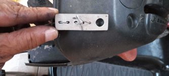

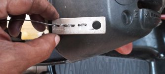

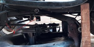

Well folks, I managed to solve the problem ... many will not like it because original pieces were not used, but it is the most viable solution for a set that has already been sacrificed, crooked and sure outside the original geometry.
Steps:
1 - 3cm increase in the Link Asm Lift FXD (101)
2 - inversion of the Bracket Deck Susp. Front (70)

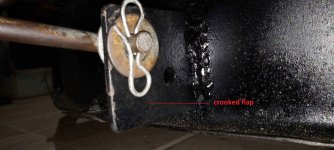

3 - the Link Lift Susp connection flap has been dented. Front Mower (98), was very crooked.
4 - Changing the Manual Clutch Cable w / Spr (only the cable not the cover) and making another termination for regulation.
The simple inversion of the 70 did not have any positive effect.
Before the modification, it was very hard to select level 5, as the arms hit the bodywork.
After the modifications and adjustments, the deck continued to vary according to the level, but less than previously and the adjustment of the cable length was essential.

Croocked flap

final
Obs.: deck without knives
