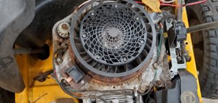

The Kohler Courage SV530-0022 has only one ignition coil with one white wire connected to it from the wiring harness. (See images.)
The red wire from the harness goes to the carb. The green wire goes to an unidentified contraption.
How would I test spark by removing the white wire?
Oil pressure switch.
By trying the start the engine. If it starts up then you must either choke the engine to death, shut the fuel supply, or pull the spark plug lead to stop the engine.

The unidentified thing the green wire goes to is the oil sending unit. On some units with the sending unit the oil light will flash when it is time to change the oil and flash for 2 hours and go out on its own. Yes remove the white wire and check for spark. If it sparks the problem is in the safety system on the tractor.

As previously mentioned, I had replaced nearly everything relating to fuel and spark on the Kohler engine - carb, fuel pump, fuel and air filter, spark plug, and ignition coil. I even corrected the lash of the valves. And, because the engine still would not start, I took it to a shop.
Come to find out, when I replaced/re-installed the ignition coil, I didn't install it close enough to the fly wheel. Its gap was too great to create spark. I should have, but didn't know that was a thing. Shop tech said it fired right up after setting the right gap. DOH!
