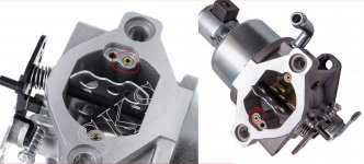

Thanks fellas. Checked out alibaba and it looks like the Ruixing clone can be found via search string "carb 594605 792768" the clone is easy to spot because of the smaller square solenoid.
Attached a photo of the stock images they're using, noticed a crack haha. If I buy one on ali I will be sure to contact seller to point out that I don't want a cracked one, heh.
Surely there is another option available, i'm just mentioning this in case it helps anyone in the future.
Will try a clean out of the carb, the chinese one I found on fleabay arrives today will see how that works.
