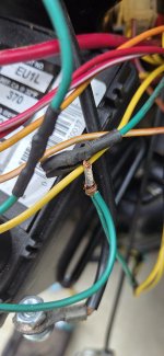

I have to thank you for the advise here, as you have mentioned that the three switches should energize starter. I've looked again the whole schema and of course the ground wasn't properly soldered where it should be!! I have soldered closed circuit not connecting it all the way to the deck switch! That explains why the spring was closing the circuit!
Awesome back in business! Thanks again rusty in reading electrical schemes it seems been while when worked on 2 cycle motorcycles ;)
Attached is my mistake;)
