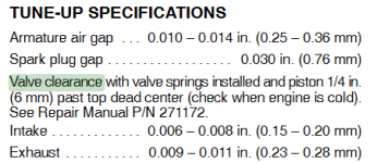

read it carefully.
The manual usually has clearances WITHOUT SPRINGS installed in the repair section and valve clearances fully assembled in the specifications section.
This is so you can check how you are going when recutting the seats or shortening the valves to reset the lash

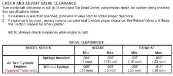

I am thinking either starter problem considering the engine age or carbon (foreign object) on piston or head cylinder head. But here is the valve adjustment info.
Opposed L-head twin cylinder engine

Well fellas, it was indeed the valve clearance! Or the carbon build up!
thanks very much for your help!
