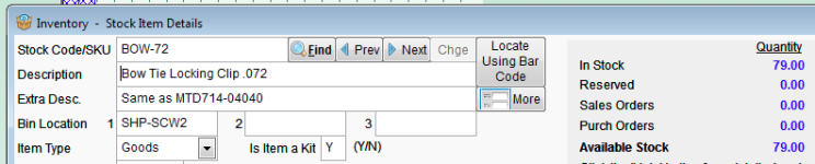

Most likely the idler pulley bearing has failed. Replacement required. You be pick up the Bow-72 (MTD 714-04040) cotters at your local small engine shop and no local hardware will not likely have these..
my shop has only a few left in stock as I use a lot of them.
