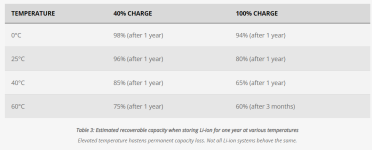

I recommend storing the battery indoors to get the longest lifespan possible, (lithium batteries do not like heat) I also store the battery at 75% charge which will retain the maximum longevity of the battery, refer to the following article to understand why:

I am careful to store the battery indoors and leave it at 50% charge to get the longest possible lifespan out of the battery, I only charge it the night before I plan to mow:
