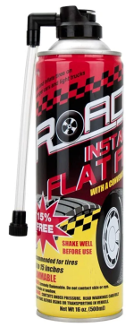

I'm not sure if you're still having a problem but I have a lt2000 the rear tire kept going flat and like little engine mentioned I tried that slime stuff and that did not work but what I did find that works and is still working because it's still holding air is a product called road instant flat fix something like that but I bought it on the big a let's call it.
So I wasted the 15 bucks on the slime stuff but for 13 bucks I got this other product

You put the other product in a tire that already had Slime in it?
You are correct I used the slime product and that did not work and then I used that other product called road instant fixes flat tire.
And I thought about this after I made my original post and I was wondering if the slime product although it did not work acted as a primer in some way and helped the second product I used to truly stop air coming out of the tire and in the mowing season of say 2023 I can't recall a problem at all with a tire and then in the mowing season of 2024 is when that tire had a problem. Right now the air temperature outside is about 18° f and it's been very cold for several days in a row and I was thinking of going out in the next couple days and checking the tire pressure on that tire to see what it is.
