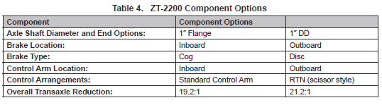

Well you would definite go slower. really depends if you DD axles or not.
only the ZJ goes a little faster than the DD axle version of the ZT2200. Now larger diameter wheel can offset this.

By sitting in the parking lot and measuring on the latest $7,000 Cub cadet I don't know what it's called It's a yellow thing with the rollover bar 24 and horsepower Kohler engine ZT3100s a 60-in deck etc by measuring It looks like if I got the whole rack out of the back with the rods that go between the transmissions all of it I could roll that out and roll it under my RZT54 and I believe the mounts and everything will line up I'm not sure about the connections to the handles and the brakes I don't know what DD axles are I know that on the mower I'm looking at at tractor supply it has five lug wheels and tires mine is four lug there are four lug axle slide over thingies or whatever you call them that have the four lug on them that you can get from hydro gear The ZT 22 00s are thicker side to side then the 31 34s or any of those so when you hang these from the top mounts looks like the fans and everything will line up but the bar is going across between the transmissions will be longer The one on mine between the 2200s I think is 14 in and you'll need 16 between the 3100s and probably the same for the 3400s other than that I don't know how the handles and the brakes will connect but it looks like they're very similar I don't know all the terminology but I have the pictures and it looks like if I could find a damaged in transit this model that I'm looking at at tractor supply ZT1 or something like that it's called looks like it could work I hate to go back to the 2200 it's impossible to change the fluid and do any work on the things it's just ridiculous like taking the engine out of the car to replace a spark plug

Your best bet is to talk to the experts, Mulligans .
I have found them to be very honest and very helpful
They will tell you what units are drop in replacements which they usually sell at the best prices I have seen on the web
They will also sell you rebuild kits
and on a good day they will tell you how to modify or repair your transmission .
Most transmissions have common mounting holes according to their category
Low end ones have the bolts on a smaller base circle and high end ones have them on a larger base circle
You can fit any transmission into any mower it just depends how much fitting you are capable of doing .
The other thing to be weary of is the power drain , hydros gobble up power so you can end up in the situation where the hydro is fine but the engine can not produce enough power to run both the drives and the blades
