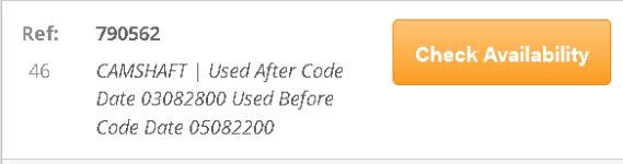

I confirm what you said per Briggs parts list for your engine. Briggs 790562 IS the correct cam.

All pictures online doesnt show a compression release on the camshaft.
Jul 14, 2019
80
5,703
My pictures came from the Briggs and Stratton store. Even put the link up for you.
It was the first hit on Google.
Both pictures show a shaft, 2 lobes, 1 gear and this funny finger like metal part with a spring.

I used what you wrote for your engine numbers
445777
0263-E1
031229YG
Found your cam at the briggs store. Unless they posted the wrong pic??? Could be......
Just hit me. Thanks for the correction. Your twin should have more lobes. My bad.... Wrong pics from briggs store.
Jul 14, 2019
80
5,703
This is the cam pic from your parts diagram at the briggs store. More lobes all around.... Again MY BAD. Sorry for the poor detective work.

Well & good Slowie,
But that is a single cylinder cam & Dave has a V twin
AFAIK the biggest B & S single is 20Hp

Well & good Slowie,
Right at the start Dave posted
445777
0263-E1
031229YG
All correct.
Again I disclosed MY mistake to all on here.
Sorry the web site thebriggsstore.com got me astray with their pictures.
