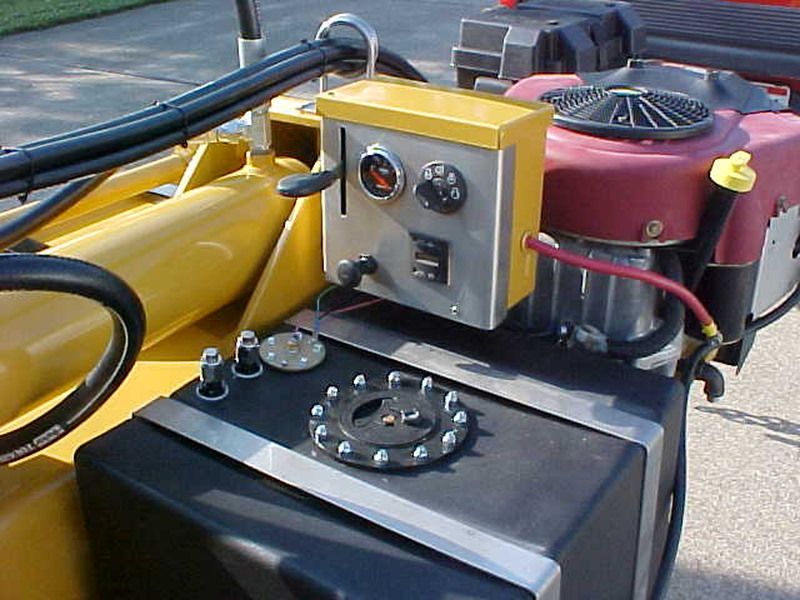

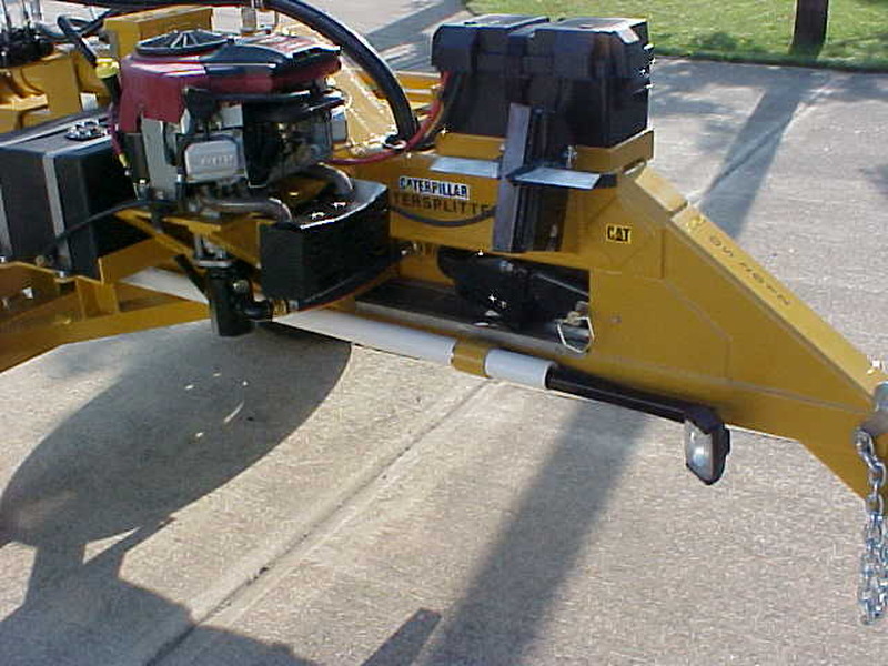

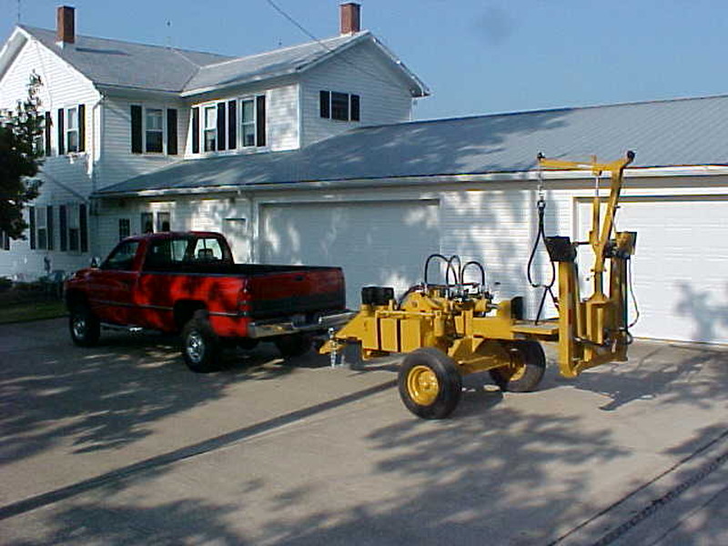

Using a Briggs engine on a wood splitter I built. About a 2 years ago the original fuel pump quit so I got a new OEM Mikuni. Put it on and worked fine. A year later, it went out again. Once again, bought an OEM and worked fine for a spitting job I had. Went to start it today and after that one time use, it's dead again. This time I've ordered a knockoff brand but want to know what brand/model of electric would be good to use if this one dies as well? Been VERY frustrating. The original pump worked fine for 8 years with no issues. I do run ethanol fuel but to die after a single use points to factory issues.Anyone else run into this? It's a 25 HP Briggs and a 808656 Fuel pump.

It's a Briggs Intek V twin 25 HP engine. Model 445777, type 0231 E1, Code 03102240. Mikuni pump # is 027013 with Briggs # being 808656. Line from tank gravity feeds out quickly, no obstructions. Engine runs perfect with gas or either sprayed into air inlet. Pump is used on a lot of engines. It's just not pumping anything no matter how much it is cranked. Fuel delivery issue.
Nice build. Just about any small fuel pump these days will work fine. You may also need a pressure regulator to drop the pressure to 1 psi as most are above that by 1.5 psi or higher. These inline pumps are all pretty much the same design. Check to see if they have check valves or anti siphon built in. And anyone trying to convince you that ethanol is killing your pulse pump is ill informed or just reading from a script.
