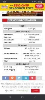

0.004" both sides
These are the specs I found online for this specific engine model. Does it seem accurate? Or should I just roll with the .004?

.003 intake
.005 Ex
Intake is the main one to get set at .003-.005. go for .003 because the ACR (Automatic compression release) is on the intake cam lobe of the valve
