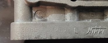

Yes is an aluminum bowl nikki.
number on top
590851 266
4818 5B
Bottom
The Partstree diagram looks like the right one.

I do have one question, that I think pertains to the main jets. Do they have anything to do with the L & R that's stamped on the carb body? As in two different size jets that are particular about being L or R? Partstree only listed 1 jet (other than high altitude).
Forest#2
Apr 17, 2022
613
Here is some info about your later model Nikki BRIGGS aluminum bowl CARB that I have on file for reference. This info will answer some of your questions about the Briggs Nikki's. Note the L in your first picture, that is the left side reference for the jets location. The texture of that carb appears that maybe it has been in the Usonic few times before the pictures. The steel bowl Nikki's are the older models and are of at least two different designs. I do not have a very good track record of trying to use the China clone replacement Nikki's although I have taken parts from the clones such as o rings, etc and installed into the real Nikki and get a good run. Amazon Prime has a free refund policy if their carbs don't work correctly so that is usually where I get Clones for testing.
I have tested the Nikki carb using both of the jets as the larger size and got a good run. I've drilled the smaller to same size as the larger jet. I also use a gasket and RTV with good results at the intake instead of trusting the O-ring. Sometimes the intake two intake gaskets come in a kit, but if not I just make them.
