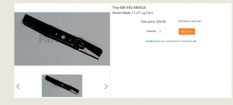

LT50 mower. Manual shows 942-05052A blades needed. They are 18”, and to long for the deck. the old ones are 17”. Anyone have any idea why the recommended blades do not fit?

Just found the 942-05052A that I received in May and they are 17.25" diagonally measured. The 942-05056A (also in stock) are 18.25" diagonally measured.
