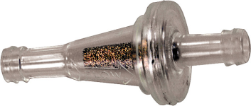

These are window screen media types. Might stop a number 2 pencil. Waste of money.
This style you can't verify the cartridge is sealed proper or not. On the fence about these.
These are supposed to be good. Never used one. What is the micron level on these?
Another I haven't used. Any good???

I use the WHITE briggs pancake filter on gravity feed engines and a Wix 33011 on pump feed.
59
15,277
I use the red Briggs filter on gravity feed engines and the white Briggs filter on engines with a fuel pump. The red disc-type filters are 150 micron, and the white (or light grey) disc-type filters are 75 micron. Both of them have brass screens in them and are for gravity feed applications. The bigger cylindrical plastic filters with the paper element inside are 60 micron, and the bigger cylindrical metal filters are 10 micron. Both of these are used in fuel pump applications.

The sintered bronze filters are really good and can be backwashed I use them on my vintage motorcycles
