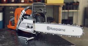

This is on the bars nose tip.
After taking a look-see, the gauge is worm. Chain wiggles way too much. The tip of the teeth, on one side has a tiny bit of damage. The other side seems fine.
72 drive links

Oregon Vesa-Cut bar 200VXLHK095 would be a good low cost choice for the bar.
Oregon 72LPX072 saw chain.
Both are very good, low cost, and the chain is a safety chain for homeowner use.

For some reason, he won't have an Oregon product. Says he wants Jonsered or Husq.
121
12,884
Well he if get either Husqvarna or Jonsered bar he going to get an Oregon bar as that's who makes the bars for them. He just be paying extra for the name to painted on it.

I'm getting the picture that it's doesn't matter if it's an 058 or an 050 gauge, as long as the bar and chain match. Is this going to have an effect on the sprocket?
Not that I know of but check the rim sprocket anyways as maybe heavy worn. Or least at the IPL says the saw is setup in a rim drive drum. It just the .058 is a heavier chain and bar will also be heavier and will affect the feel of the saw.
