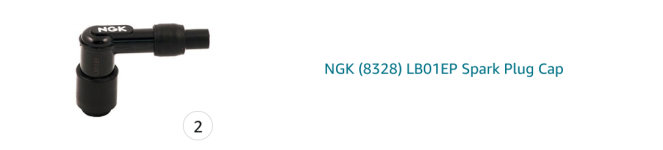

The Kawasaki coil wires are carbon track units and they have had problems with continuity before. Ask me how I know. The plug boot connectors are just crimped around the cable with a small spike penetrating the sheath to contact the carbon coated string. Check these as well. I have replaced mine with these....much more secure connection.

Hmmm. I don't use those type terminals here as the high tension leads are strip back and conductor folded back and the terminals are then crimped in place. Matter of fact I replace high tension leads whenever mice chew them in two.
Using those spike type of terminals are just asking for problems.

Damn hard to replace carbon track when they are moulded into the coil housing.
There is a screw in the cap that screws about 3/4" up into the cable...nothing gets "peeled back".

Most high tension lead are not molded into the coils. They are either screwed in or push in (depending the pin used) and while epoxy holds them in place afterwards. It does however requires very sharp skinny blade knife to do this.
