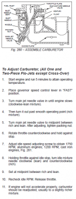

These updraft carbs can be tricky to adjust provided the engine is in good condition. Most of the TB tillers are very old (mid 80's-90s) that have this engine. So it can simply wear and tear on engine. Valve clearances are likely to have closed up and cylinder can be heavily worn.
But here the instructions on how to tune the two piece Flo-Jet carburetor. Note you will need a tachometer for these adjustments.
