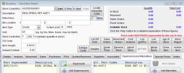

I've taken the cover off the transmission and found the broken retaining ring. Any idea where I can get a replacement?
Still this the ring? Item 40?
If so the Hydro Gear PN is 44871. Just Google "Hydro Gear 44871" for sources.
A
amentac
Yes that's it. I couldn't find it under the old part number 170393. Thank you.
Ahhh. Husqvarna part number that has been superseded. You will better price using the Hydro Gear PN.
