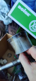

UPDATE! I disassembled (and carefully ziploc bagged parts for reassembly [The reverse of disassembly!]) and I found the top piston ring had broken at some point. There is some damage to the piston, though it does not seem warped out of shape in any way. I have new rings but the damage affected the channels the rings sit in, meaning I think I need to carefully file down the damage to the channels until it is smooth and de-burred. I would buy a new piston if I could find one!

Post your serial number for the 8237. There are some piston and ring sets available depending on the year of manufacture.
