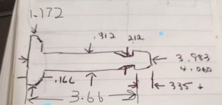

he thinks he wants me to rebuild the engine which is rings and i may grind and lap the valves, but i wonder if i should be looking at the decompression on the cam? i looked thru the plug hole at the valves and the exhaust looks a bit dark around the seat and on my 9 hp flathead it had a bit of a ring that tells me that valve is seating.
today i will tear it apart and take a closer look but i'm leaning on valves and not rings. but because i have it apart i will do rings also being they are cheap and it is apart
