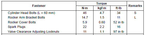

Kawasaki service manual says 97 Inch lbs. 15 ft lbs for bracket bolts.
Hmmm my manual says different. It has it at 11 ft/lbs. Quite a bit difference between 180 in/lbs and 132 in/lbs.
