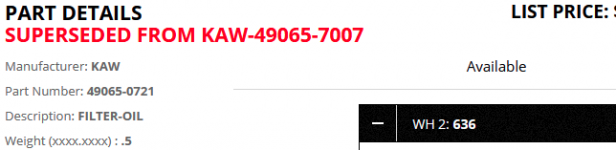

Seems most sites claim the 0721 superceded the 7007 or they show the 7007 but if you put in the 0721 is says it is not found. Nobody had a cross for the 0721 filter either to another brand. If I put the 7007 into the parts lookup systems, it shows every engine that it was used on. If I put in the 0721 there is no engine reference.

49065-7007?Kawasaki only has two filters 49065-0721 an 49065-0724 they are completely interchangeable as long they will screw on the oil filter housing and nothing interferes with the fit.
I'll tell ya I have both these filters here, & the 49065--0724 is a very skinny filter in comparison. I will try & avoid using it. But that's just a preference.Kawasaki only has two filters 49065-0721 and the 49065-0724 they are completely interchangeable as long they will screw on the oil filter housing and nothing interferes with the fit.
And know I was told the 49065-0721 is replaced with 49065-0724, IDK about that ?Funny if I wanted to use the 49065-721 the distributor I use warehouse has plenty but I usually just use the AM Briggs replacement filter I have in stock. Of course 636 filters might less than you need.

Been using OE 49065-7007 since day 1, now filters I have coming are said to be 49065-0721.
Here's a list of filters that will work,Is this legit ? I can't get any info off the Kawasaki engine site.
