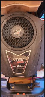

Hi, new member here and looking for some input. I have about 10 year old Husqvarna YTH2041 42" 20Hp Briggs & Stratton that won't start all of a sudden.
I drove it into my shed after mowing the lawn 5 weeks ago and since we've been in a drought I haven't needed to mow but went to start it and nothing, maybe a 1/4 turn and dead. I thought it might be a battery, bought one and same thing. Returned thinking it might be dead, 2nd new battery same outcome. At that point I am thinking solenoid, starter or ignition, I ordered the parts the next week I go to turn it over and the new battery I bought the week prior was down to 3 volts. Hooked up jumper cables and the motor spun then gets caught up and can't get past the compression stroke. We pulled the cover and the keyway is in perfect condition, the vales aren't stuck so I am at a loss and trying to save $3,000 + buying a new machine especially since I have a great triple bagger that I modified from my old Craftsman to fit on the Husqvarna and everything I've looked at so far don't seem to be compatible with the bagger.
My one neighbor seems to think it's out of timing internally but as I stated the culprit you'd think it was, a twisted keyway, is not the issue that looks brand new. I've already had to change a head gasket on this motor about 3 years in and at the time was told the single cylinder is a bad design and the flaw is known to B&S but I don't know anything other than the damn thing cost me $300 to get fixed and now I can see a repair bill growing and growing since 2 mechanics by trade, were with me and don't know what to think at this point.
Any advice or feedback would be appreciated. I think I need to bite the bullet and buy the Zero Turn mower I always wanted but of course the wife thinks I should try to fix the 10 year old machine. It is in great condition otherwise so I wouldn't mind saving $3000+
Thanks in advance,​
John
