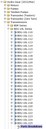

Strange I can't even get the Hydro Gear dealer portal to pull up the BDU-10L-225 pump on the search mode but did manage to it otherwise on the portal. The IPL only shows the pump section even though the BDU-10L series is listed as a transaxle/transmission.
Any way I added the CC-918-3243 to my inventory as the MTD price file has NLA it. I also added the BDU-10/21 repair manual to my database.
View attachment 67734View attachment 67735
Doesn't look like the search function is working with any model number
