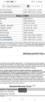

I check both intake and exhaust.. .006 (intake) and .010 (exhaust)
The steel rod has never been re-adjusted.

Valves are a touch on the loose side, but I don't believe it to be your issue.
Exhaust .005 to .007
Intake .003 to.005

Have you ever removed the engine shroud and checked the cooling fins and engine for grass, dirt, debris build up? Set valves at .004” and .006”, intake and exhaust. This is just a run of the mill single cylinder Briggs. Don’t baby it. Make sure oil is changed at needed intervals, check level periodically, and run it.
