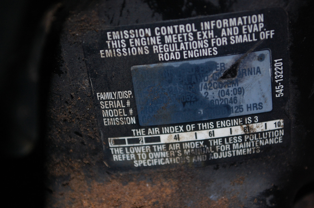

Working on a 14" poulan Wood shark Chainsaw, I can't find a model number on it anywhere so i can order the proper parts. all i can find are the emission tag numbers..
Anyone know where they put it?

Poulan saws normally have the model # on clutch cover, recoil housing or both. I have a wood shark model 1950. Post a pic of all 4 sides of your saw if don't find it.

there it is! light from the flash helped, but it appears to be wiped out.
It is there scrubby
Take some photos of the tag in good strong sunlight
Then open a COPY of each photo in your favourite photo editor.
Play with the contrast settings and the numbers will jump out & bite you
You may need to get some from different photos
The dark area will respond better to inverting ( make negative on some apps ) .
Appears to be a Poulan Woodshark P3314 WSA 802046 and it is a type 2 version.
P3314 WSA type 2

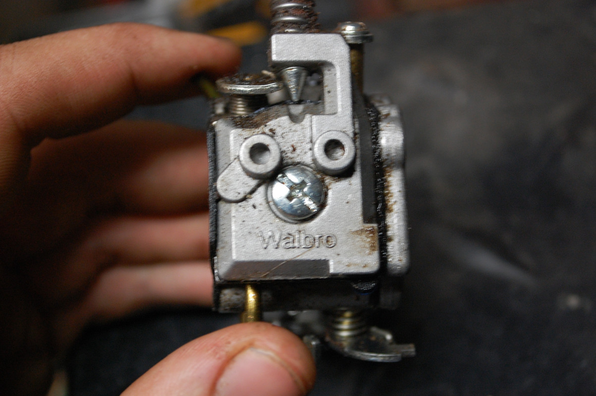

Okay, tore into the saw tonight, the fuel lines were all brittle and just snapped like a dry noodle.. so i wasn't able to see where they went. as in which one supplies the fuel and which one is the primer line that goes from the tank to the bulb to the carb.
when i press the primer bulb, air shoots out of the top fitting/nipple on it, so i would assume that one goes to the carb.
Also it uses a Walbro carb. I notice the link Star gave me lists it as a Zama carbatrator. They look identical so could i swap the walbro for a Zama?

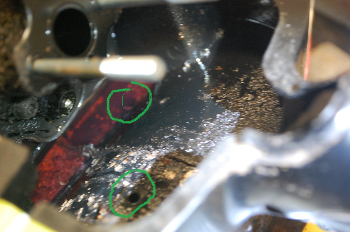

#16
Some photo's.
There are 2 holes in the fuel tank, one is lower in the back corner, so i assume the lower one would go to the fuel line, and the one higher (above fuel level) would go to the primer....
2, This is the only identification of the carb i can find is 'Walbro'.. no numbers or anything else anywhere.

Walbro WTA30 2949, found it ;)
walbro lits it like this on their website WTA-30-1
Found a rebuild kit part number, K20-WTA
The longer nipple on the primer which should be the one that the air shooting out is the tank return. In your above picture the nipple being held by your thumb is the line from the tank with the fuel filter. the nipple being held by your finger is the one that connects to the short nipple on the primer.
