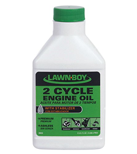

I think it's important in any discussion to define the terms and talk about the same things to avoid misunderstanding. By that I mean for example when someone suggests gas oil mix ratios of 50-1 or 100-1 we're definitely not talking about the LawnBoy oil in the green can. Don't do this.

Picked up a case of Lawn Boy 2-cycle engine oil. With stabilizer. No other specs at all. Mixes 16 to 64:1 Product of USA. #89930 for 8 oz. Sure hope it's not some ultra low emission stuff that sucks as a lubricant like the SN spec. motor oil. Guess I'll find out over time.
