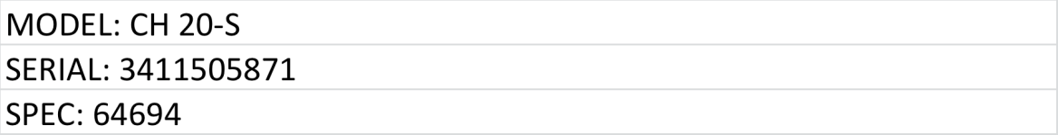

so which cylinder is not performing well? Make model serial number. How many hours on the engine. Is the RPM down or just the speed?
I don’t know how to tell which cylinder isn’t performing well. 1,100 hours. I believe it’s the RPM that’s decreased.
